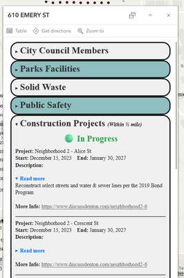

Link to the final product, a tool for residents to type in their address and pull back a bunch of info. This will be embedded into a website in the end.
https://experience.arcgis.com/experience/9d0c2f2a1ad748008a20d95729c7f4d7

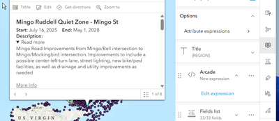

You can use an Arcade element to return the formatted text
var output = `<h3 style='margin:0;'>Mingo Ruddell Quiet Zone - Mingo St</h3><strong>Start:</strong> July 16, 2025 &nbsp;&nbsp; <strong>End:</strong> May 1, 2028<br><strong>Description:</strong><br><details><summary>Read more</summary>Mingo Road Improvements from Mingo/Bell intersection to Mingo/Mockingbird intersection. Improvements to include a possible center-left-turn lane, street lighting, new bike/ped facilities, as well as drainage and utility improvements as needed</details><br><a href='somewebite.com' target='_blank'>More Info</a></div>`
return {
	type : 'text',
	text : output
and it looks like you have an extra </div> at the end of the string

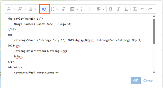

An alternative is to use the text content block as you were, but I think you just missed where to enter the code? Enter it here, then when you're done, click the same button (the "OK" button will remain grayed out while you're in there):

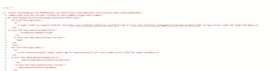

In other parts of the HTML of this pop up I was able to successfully call expressions in both the HTML code (to control A picture or URL) and to be able to return values as such
<a href="{expression/expr28}" target="_blank"><img src="{expression/expr27}" alt="Council Member Picture" width="120" height="150">&nbsp;</a>
</p>
<p style="font-family:montserrat;margin:5px 0;">
<span><strong>{expression/expr1}</strong></span>
</p>
<p style="font-family:montserrat;font-size:12px;">
<span>{expression/expr26}</span>&nbsp;

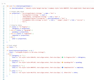

I got this figured out finally. @MarkBockenhauer, you suggestion lead me in the right direction. I switched from a text content block in the pop up to an arcade content. I then took the HTML of the formatted Text and converted it to an expression
 When I came across the expression in the Formatted HTML that was causing the issue, I just brought the Arcade code out from that Expression and into the Arcade Content for the pop
and just called the variable back.
and now it works!
