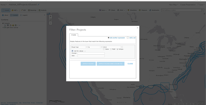

I'm also have trouble with the filter template. I've attached a document with an image of the problem.
I want the user to be able to filter through any Fiscal Year in the web app, but when I set up the expression and click, "Ask for values", I can't save my edits. My web map is hosted from ArcGIS Pro as a feature service and there are only 7 values to choose from. Do you know why it's not letting me apply interactive filters?
Thanks!
IanWittenmyer
HI Cara,  based on your screenshot it looks like the 'apply filter button' isn't active because you still need to populate the 'Prompt' and 'Hint' values.  these are used to provide the end user with guidance on how to change the values in the filter

CaraMayo2
Oh wow, that was simple. Thank you for your help!

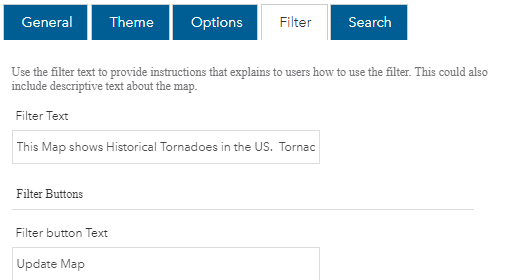

Hi Cara, sorry for the slow response on this.  One strategy for this would be to do something like in this example where I have set the year field to be a range between two values.  If your goal is to show all years by default you could have the filter show dates between the first and last fiscal year.  If your goal is to show one year, you could set the start and end year to be the same value.  Either way you should provide some hint text to assist users in exploring the data.  In this case, I created the Year filter first and then type (in this case Fujita Scale) second.  This text is all defined within the map viewer when you are creating the filter.
Filter Between
You can also provide more custom text within the app above the filter settings.   in this example built using the filter above, you can see the default text "Filter the layer by specifying values."  In this example 2, I've authored some additional helper text add added it via the Filter Text dialog within the app configuration panel.  filter text config
let me know if you have any questions.
