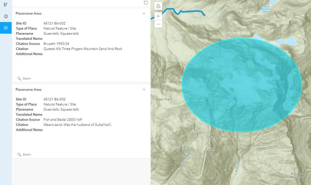

I don't know if this will meet your needs but how about using a joined table to your community names? The table would have a 1:many relationship to your community names and contain all of the properties associated with that community.
I did something a little similar where I had geographic areas that had multiple literary citations and used the table join with one of the Instant apps to provide access to the info (it's internal, sorry). As you can see, the associated records are shown in the infoWindow sidebar with a "zoom to" option for each feature.
Ken-Middleton
Thanks for this. Interesting idea. This would start with the community, then zoom to individual properties, whereas I've been thinking about just zooming to the community coordinates where users can see the property symbols that also include popups that include links to related sources. I'll give the joined table a try. Just not sure how this will play out with what we are trying to show and its use in a story map. The towns for instance, have up to 30 properties, which may be too many for this approach to work well. But I won't know until I try it. Thanks.
