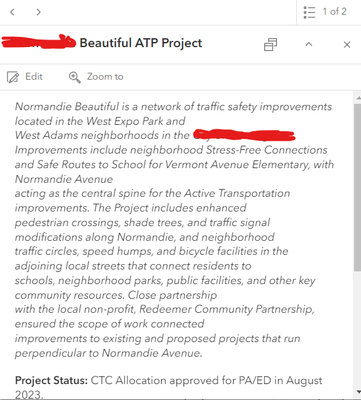

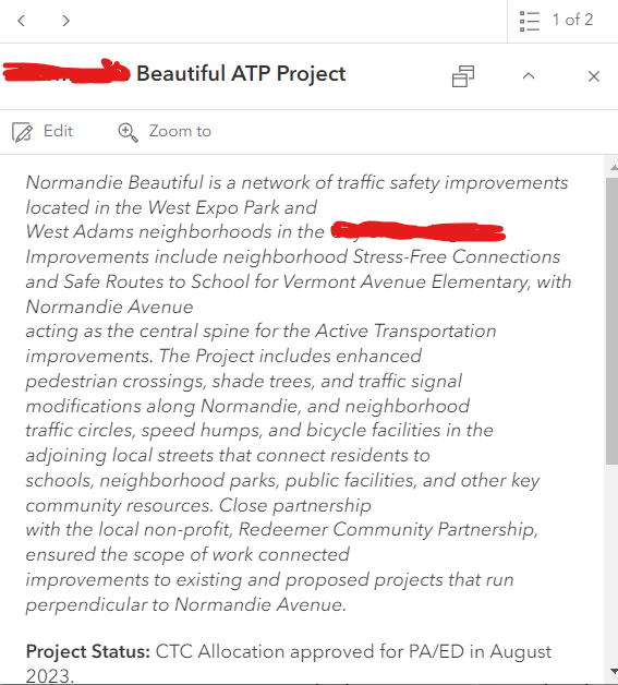

Hello everyone,
My team and I have been having issues with displaying paragraphs of text in Pop-ups. Down below is an example of the text indenting in weird areas. Does anyone know how to indent the text consistently? Is there some sort of function that strips perceived white space?
jcarlson
MVP Alum
Use something like your browser's web developer tools to look at the raw text there. The only reason I can think it would do that is there are inadvertently newline characters being included. Was the text copied and pasted from a PDF or something? I get accidental newlines when I do that.
If there are newline characters being included, you can "clean" them out with a field calculation or an Arcade expression that uses Replace.
