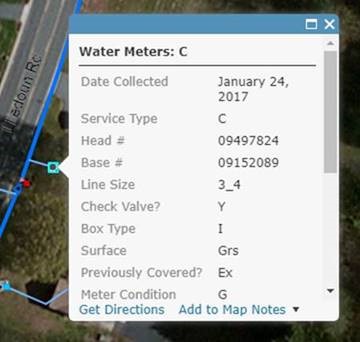

In WebApps or WebMaps, a user can search for a feature using the search box.  When a feature is found, the webmap or webapp zooms into the feature, and brings up a pop-up box.  In my experience, however, the pop-up box does not display the domain aliases, but rather only the coded values, which is Greek to the user.  The user has to click-off and then re-click onto the feature in order for domain aliases to show up in the pop-up box.  Which most users will not know to do.
Initial search (note lack of aliases, just the underlying codes):
Pop-up lacking domain aliases, after initial search for feature from AGOL search-box

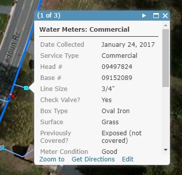

After clicking away and re-selecting (note the domain aliases now appear):
Search box after clicking away from selected feature and then re-selecting

Thanks for reporting the issue. We will take a look into this. Could either of you share your web map? I'd also recommend reporting the issue to technical support.
TomBell1
Hi Kelly,
My webapps no longer show the pop-up's without the domain aliases and things look right.  Thank you so much for your help!
