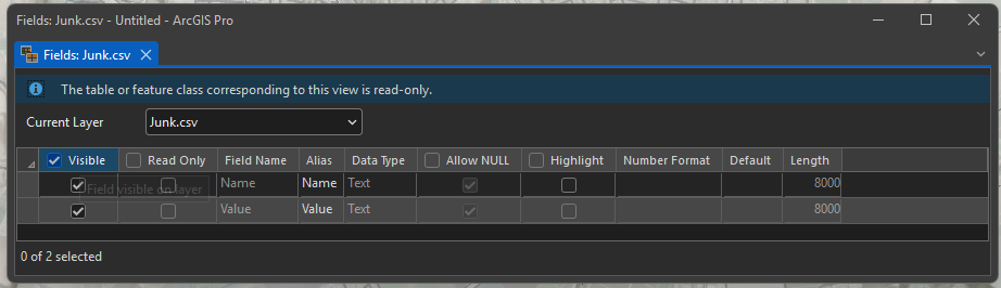

Try exporting that Excel table to a CSV. I just created a dummy CSV that had 300 characters of junk in one of the fields, and short text in the other.
It brought in both fields as 8000 length strings without any intervention. If that hadn't worked, I was going to try altering the schema.ini to force a longer text length, but it seems to have done it natively.
I am on the newest 3.5.4 version of ArcGIS Pro.

mgsaldan
This worked, thank you. I had tried csv with export table tool and had no luck with that, but hadn't tried adding the csv directly to the contents pane.
