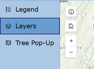

I am using a custom CSS to add focus to all elements in my side bar app. This has been achieved for all elements except for the "introduction window" icon on the main page. The home button works but if I use focus on the info, it doesn't show.
For my own accessibility needs I require focus, so this is not just for public users but also a personal need. I have to make this work. Same with icon size, they are too small (need to be at least 24px), and I need to turn zoom on to see them.
This is my focus CSS:
:root, .calcite-mode-light {
--calcite-icon-color:#000000;
--calcite-color-focus: #1C1C6D;
Thanks!

The outline issue is a bug in the Sidebar app we'll work on a fix for that issue. Currently the target for the buttons on the map are 32x32 so they meet the target size requirements here:
https://www.w3.org/WAI/WCAG22/Understanding/target-size-minimum.html
You could update the icon color using this if changing the color would help?
--calcite-icon-color:red;

We have a fix for the focus issue for the info button and it will start working in Online within the next week. In records to the icon size I'm sorry for the confusion I didn't mean that the icon size was 24x24 rather the target (the button) is that size.
We do plan to add support for additional customization capabilities especially for mobile and increasing button size or optionally adding in a text label in a future release of Online so we'd love to hear feedback about specific things you've had to modify via HTML and CSS so we can provide configuration options to make this easier.

I still have my icon colors and focus, except on the introduction window Icon. Also, I just use black text for everything and darker blue background for hover and focus that still keeps a good contrast with the black text. Unfortunately, the hover colors work for everything except Zoom controls, and the home button.
My focus should be for everything this darker blue with a dark focus. Except nothing for legend. Now legend has the custom hover.
But the color now disappears on the floating icons, and nothing for the "i".

The focus issue for the info button is fixed on arcgis.com now. If you refresh your app you should see the update. If not you may need to clear your cache.
And here's the css I use in my test app to set the hover color for all the map buttons (including home and zoom)
  --calcite-color-focus: magenta;
  --calcite-icon-color: #333;
.esri-widget--button:hover {
  --calcite-icon-color: #fff;
--calcite-color-border-3: blue;
--calcite-action-background-color-hover: blue;
