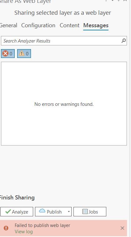

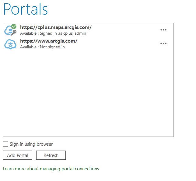

I am just setting up an academic account for up to 5 users of ArcGIS Pro and ArcGIS Online and I just realized that whenever I try to upload something from ArcGIS Pro to ArcGIS Online the process fails.
I don't know if this is a problem, but I have a personal ArcGIS Pro and ArcGIS Online account, which has no such problem.

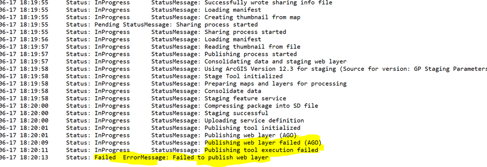

I will leave the logs of the problem and some images, I remain attentive to your comments.
Best regards, Nicolas.
LOGS:

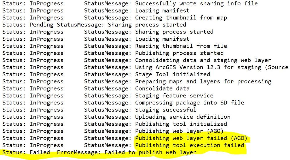

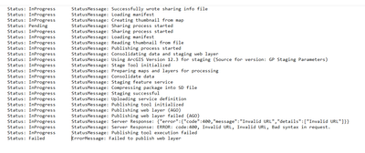

Thank you very much for your answer, I tried with another dataset, a very simple one, and it failed to publish from ArcGIS Pro to ArcGIS Online. It gives me the same error.
This is the dataset I created:
The unusual thing is that with my personal ArcGIS Pro and Online account I don't have the problem, I only have the problem with the Institutional account that I am using, where I was asked to be the administrator.
Here are the logs:
