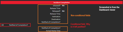

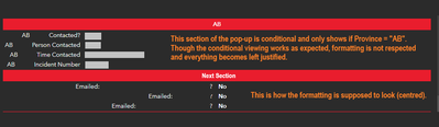

Though formatting worked fine in the pop-up, in the dashboard for this data, none of the formatting was respected, and everything was left aligned (see screenshot 1).
I will cross-post this to the dashboard forums, but thought it was worth adding here as there is an additional field that doesn't respect formatting in either the map viewer pop-up or the dashboard viewer.
That item is a conditional field that lives in a table where all other fields are not conditional. To apply the conditional expression, I added the display attribute in the <tr> tag for the field as opposed to the table tag:
<tr style="display:{expression/expr0};" valign="top">
    <td style="padding:2px 10px 2px 2px;text-align:right;width:50%;">
		AB Notified
    </td>
    <td style="padding:2px;text-align:left;width:50%;">
		<strong>{notify_ab}</strong>
    </td>
</tr>
As seen in the second (map viewer pop-up) and third (dashboard) screenshots, the text-align calls are not respected and everything is pushed left.

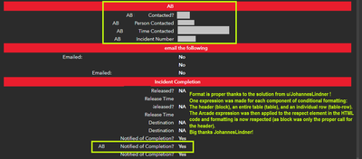

Ahh that worked perfectly (screenshot below)! Thank you so much for taking time to respond and give such a detailed and thorough solutions and explanation. I really appreciate it!!
I'm going to put a blog post together when I have a moment to go through this conditional pop-up workflow as I haven't seen one in my searches (I saw several to hide if empty/do something if not empty, but not be conditional based on a field attribute). I'll be sure to credit you for your help when I put that together.
Thanks again and have a fantastic day 🙂
