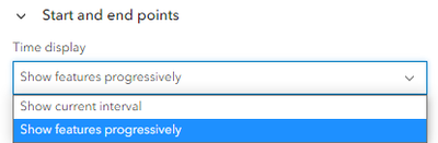

Do you have the time setup under Map Viewer settings set to current interval or features progressively? If you only want the current features shown have it switched to current interval.
AndrewCastilloTBSL

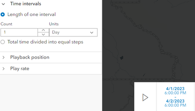

So, I had it at show features progressively instead of show current interval. Is there a way to get the Length of one interval to 0 days so that it starts on April 1st- April 1st instead of April 1st - Aril 2nd.
