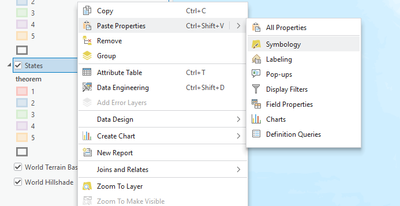

There is currently not possible in Map Viewer. It is on our roadmap to support this behavior. For now if you have access to Pro you can open the web map and copy the original layer and on the new layer you will see Paste Properties where you can apply the symbology. For the filter you could take the SQL of the first layer and paste it into the second layers definition expression sql editor.
