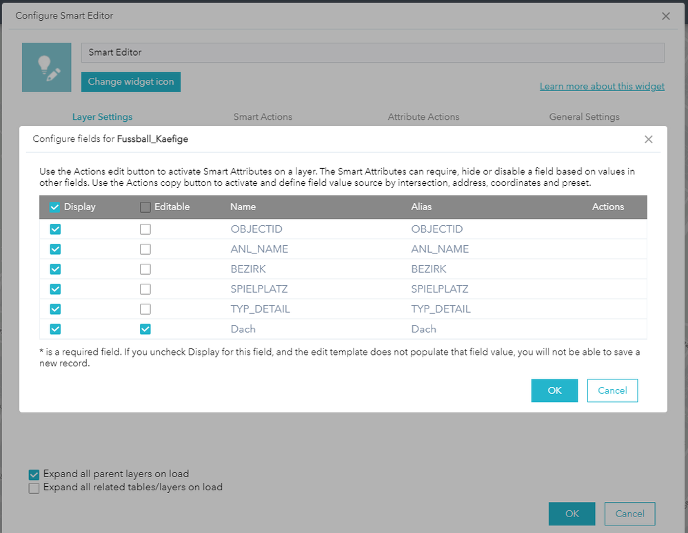

Hey Rudy thank you very much 🙂 it worked with Chrome on my mobile phone too! webmap_question.png
For the second question I enabled editing and added the editing widget like you told me, but I want to add something in my field ("Dach") it says: "the value entered is not valid". I checked the data type for the field an it is correct with "string". What am I doing wrong :(?
Thx.
