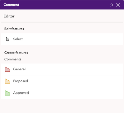

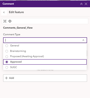

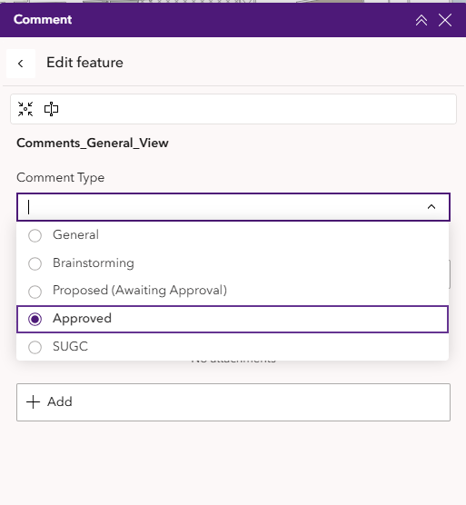

I have a view layer in a map that is filter to only show the TYPE values of "General", "Proposed" and "Approved", but the root layer also has "SUGC" and "Brainstorming" in the domain. When the edit form appears, it does only show the values I want to see, however once a user selections an option and starts to create a feature (or edits one already made), they are able to select the options that are filtered out from the view, which results in the feature disappearing from their map.
Is there a way to mitigate this? I have only the values I want them to be able to choose from in the template as well.

It is a layer used by different users to make comments about spaces and their use. We want some users only have access to see certain comments (general, pending and approved) and other users to have access to all of them, including those made in space planning meetings. As of right now, they can't see any other comments, which is what we want, I just worry if they choose the incorrect type then their comment will disappear for them and they cannot correct it.
