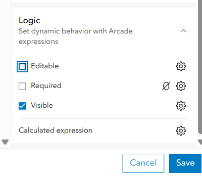

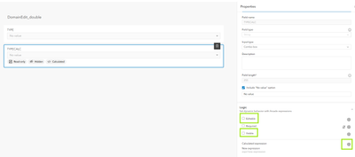

In Configure forms, make a form field for TYPECALC that is not editable, not visible, and has an Arcade expression.
IIf(
  $feature.TYPE == "1" || $feature.TYPE == "2" || $feature.TYPE == "3",
  $feature.TYPE,
  null
This ensures TYPECALC is not editable from the source layer.

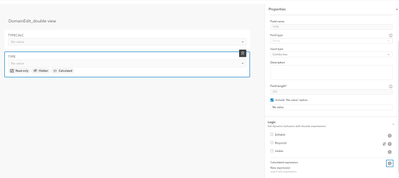

In Configure forms:
Add your TYPECALC field as usual.
Make a TYPE field not editable or visible.
This time, the expression is simply:
$feature.TYPECALC
This ensures all the edits in the view are also saved to the TYPE field in the source layer.
