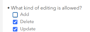

One possible solution would be to use hosted feature layer views and set different editing permissions on the views.
For example, View 1 could have editing enabled and allow users to add features.
Subsequent Views (2 and 3) could have editing enabled but not allow users to add features.
