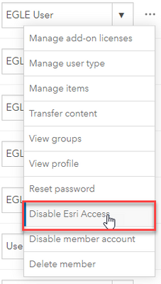

We have discovered you can reuse usernames ONLY if you have disabled Esri Access for BEFORE deleting. Otherwise, when you "delete" you're just removing them from the organization but not globally across all of ArcGIS Online. If they still have Esri Access enabled on deletion then their account persists (idk I guess so that they can access their training record and posts on GeoNet?). If you disable before deleting you can recreate the same name no problem.

@LisaT , there's no way to do this once you deleted someone. The ONLY way to prevent this is to be sure to disable Esri Access before deleting.

I was facing this same problem recently. I did a test by adding a user and then deleting it. The "Enable Esri Access" option was disabled. I was able to add a new member with the same username without any problems. When I tried to add another username that was deleted with "Enable Esri Access" turned on, I couldn't.
