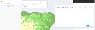

@BlakeMorrison - sorry if I'm missing something, but the Living Atlas item (Item ID: e393da08765940e49e27e30e1df02b58) is already configured to return elevation. It does this via a text pop-up. If you add this item to maps, it should respect this.
If you've indexed it to your Portal as a new item - as possibly looks the case - it may have lost the pop-up, so you just need to copy the settings from the original and save your version:
Hope that helps!
