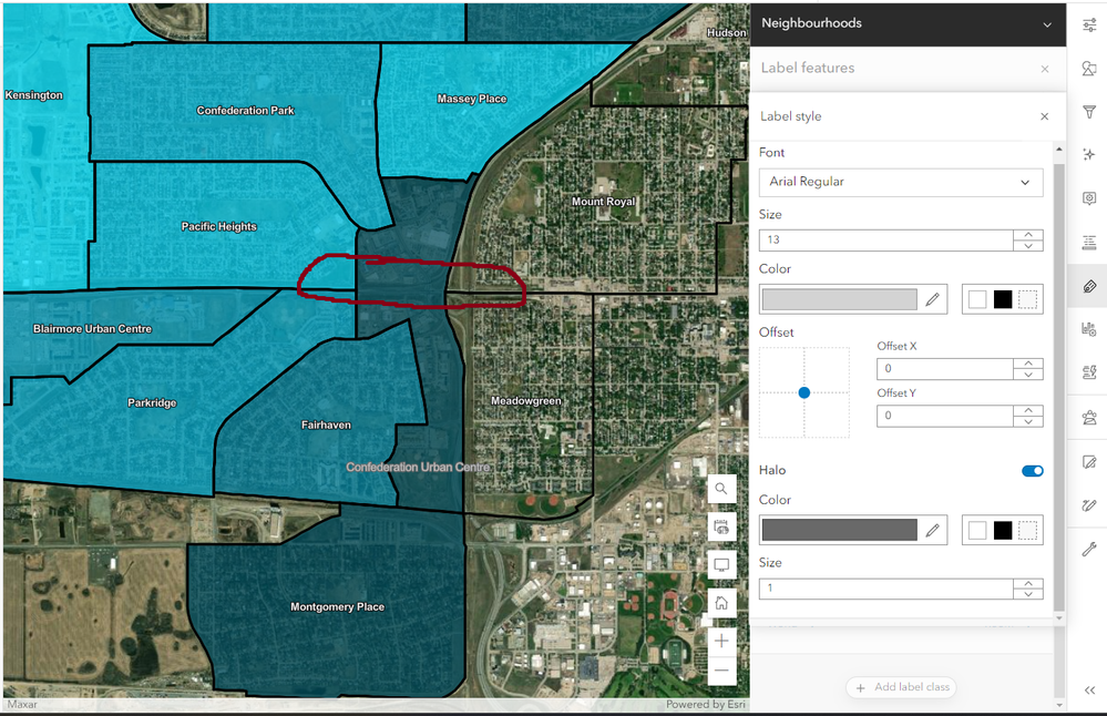

JirehJuson
Greetings all new to the field of GIS and learning ArcGIS Online.
How do I move the Confederation Urban Center higher up inside the red circle?
Offset can only move it so much...
EmilyGeo
Hi @JirehJuson
Label styling doesn't really offer you that level of control over the placement of 1 label. But, you do have some options.
One option that could work when you just want control over 1 label would be to:
1. Use the Label Filter to filter out the label for that feature.
2. Then create a new Sketch layer, choose the text tool, and use that to place the label wherever you would like.
For more info on creating a sketch layer, see the help article here.
