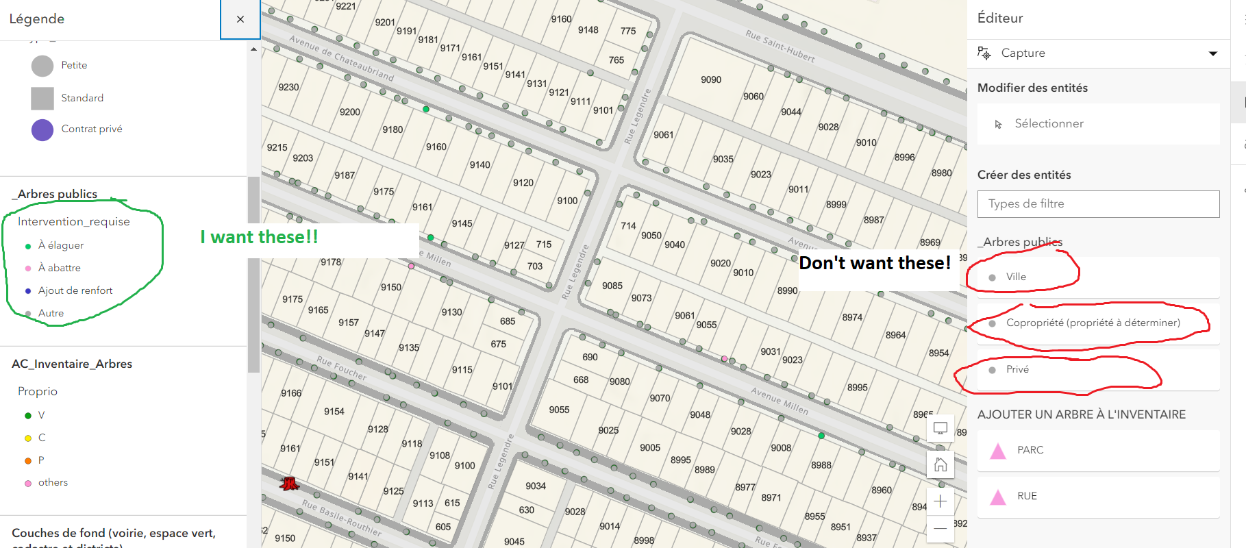

I have a hosted feature layer which I enabled the function to add new point on Map Viewer. When I add a new point, it automatically ask me which value I want for one of my field (the owner). I'd like to change that first field for another field that match the legend (what kind of work we need to do).

My legend is showing unique symbols for one of my field. But when I want to add a new feature, it ask me to select from three values from another field (not the same as the legend). Why? How can I change this?
