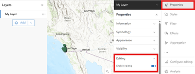

If you want to turn off Editing for the layer in that map, you can do the following:
  • Select the layer
  • Open Properties
  • Go to the Editing section
  • Toggle Enable editing to the off position
If you want to turn off Editing for that layer in all maps, you'll need to change the Editing settings for the layer.
