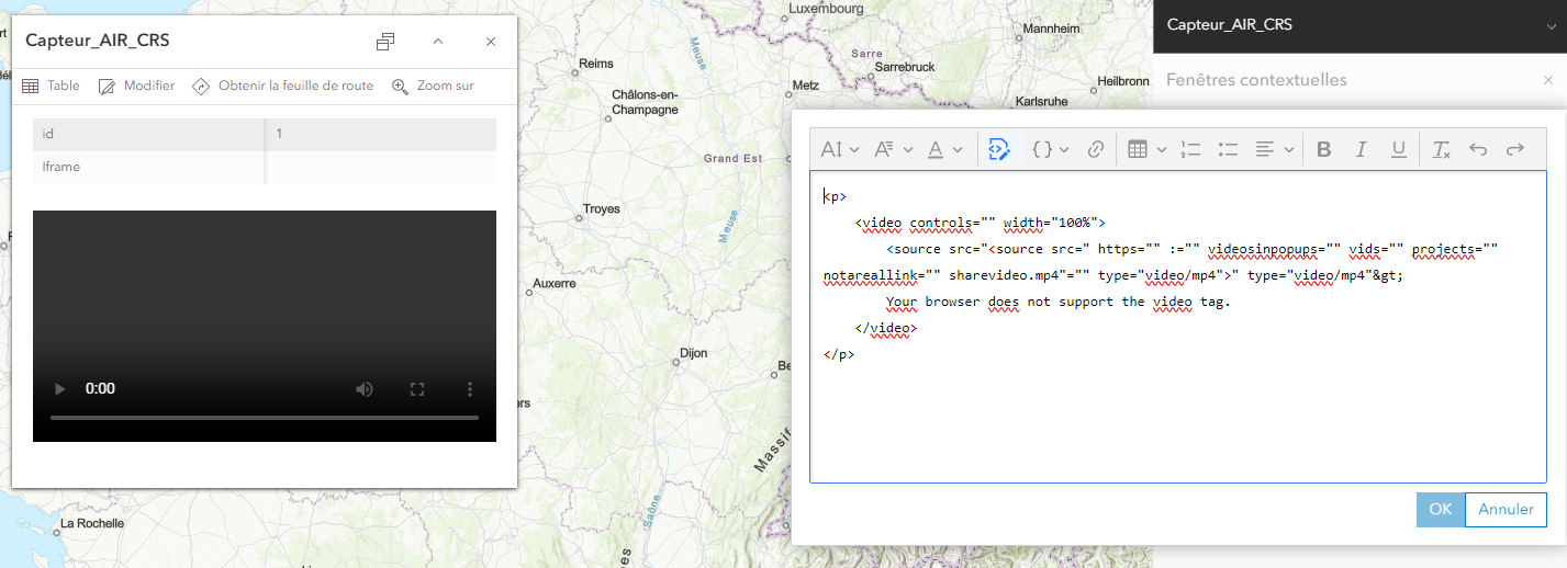

I have been trying to figure out how to embed a website in ArcGis Online popups but could not get it to work. I 'm trying to get sort of an iframe containing the third party website (https) in the popup so that user cans see that page when they click on a feature.
I have tried the method to have an attribute with the Iframe HTML as some suggested in earlier version it was interpreted correctly but it seems this is not the case anymore.
I have found that there’s a way to embed video for example but nothing for integrating a website.
So if you have any suggestion that would be great. Thanks.

This is not possible and the popup will get sanitized once saved and remove that iframe.  This is done for security reasons.
