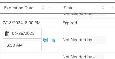

The way to do this would be to either edit the feature layer that you're using and add a date field, or if there is already a date field available, you can use it to edit the expiry date like this here, entering a date and time along with status field if you would like:
