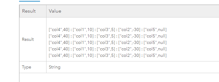

BrittanyBurson
Thank you for posting this! This is so helpful for what I am trying to do. However, I wonder if something has changed since you posted it -- I am getting a different return list result when copy/pasting exactly as is? I will keep trying to adapt it with my basic Arcade skills, but if you happen to see this, suggestions are appreciated! Thank you.
