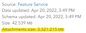

Found this post and am wondering if there are any ideas on the disparity I see when querying the size of the attachments through the Python API versus what is shown on the item page...?
If I query the attachments through the Python API for a feature layer of interest, I get 1.35GB.  However, if I look at the item page, it shows 3.3GB.
Python API query --- bytes converted to GB
Item page
mpboyle
Honored Contributor
I believe I have resolved my issue, which is the number of attachments is greater than the max record count of the service.  In order to retrieve all attachments, I needed to use the "max_records" and "offset" parameters.
