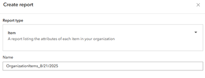

CodyPatterson
MVP Regular Contributor
Hey @L77
You can go through the Organization -> Status -> Reports page to get all the items in your organization into an excel sheet like this here:
Cody

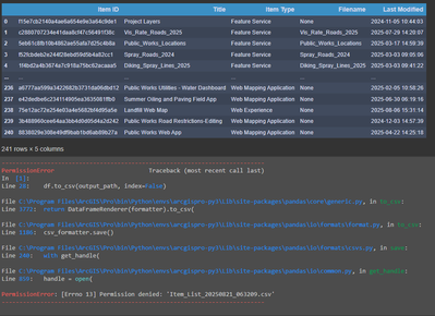

L77
@CodyPatterson Getting basic permissions here is difficult.
I ran the script you gave me and this was the result:
This is my backup script I have been using below.
I want to download everything that is currently in my account that I am the owner of one time, Then I would like to get a list of the item names and corresponding ID's so I can go through and pick which item id's I want to put in my backup script moving forward.

CodyPatterson
Hey @L77
I see I see, I still think the permissions should be given to you, but for now I see where you're trying to get, for my script, you may want to use it as informational rather than creating a CSV, there may be an issue with your permissions and programmatically creating things:
from arcgis.gis import GIS
import pandas as pd
from datetime import datetime
gis = GIS("home")
item_types = ["Feature Service", "Web Map", "Web Mapping Application"]
items_list = []
for item_type in item_types:
    query = f"owner:{gis.users.me.username} type:{item_type}"
    search_results = gis.content.search(query=query, max_items=1000) # May need to adjust this
    for item in search_results:
        filename = item.get("name", "N/A")
        items_list.append({
            "Item ID": item.id,
            "Title": item.title,
            "Item Type": item.type,
            "Filename": filename,
            "Last Modified": datetime.fromtimestamp(item.modified / 1000).strftime('%Y-%m-%d %H:%M:%S')
df = pd.DataFrame(items_list)
for item in items_list:
    print(item)
Cody
L77
@CodyPatterson That worked, thank you!
