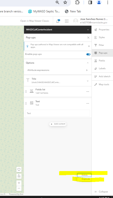

Hello everyone,
I added two text elements in a popup window  in a layer using Map Viewer in ArcGIS Portal, but I do not find a way to remove one of the text elements.
How to delete a text element field in a pop-up window?
Thanks

bbollin
@SanchezNuñez  do you not see the delete button? (Under the ellipses)
SanchezNuñez
Thank you @bbollin
I tried several times in our ArcGIS Portal, but the delete button does not show when I click in the ellipsis.
Thanks
bbollin
I am unable to reproduce that issue @SanchezNuñez. Do you own the data? Are you seeing this with all pop-up text elements?
SanchezNuñez
Found a way to see the delete button. Zoom out in the Web Map and then it shows the "delete" button after scrolling down.
bbollin
@SanchezNuñez, looks like this issue was fixed in 11.2. Thanks! If you use FireFox in 11.1 it also should work
