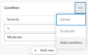

JenniferAcunto
You can create a condition group by clicking on the three dots and select add condition.
From there you can select if any are true (or) or if all are true (and) for that specific group.

JenniferAcunto
- Jen

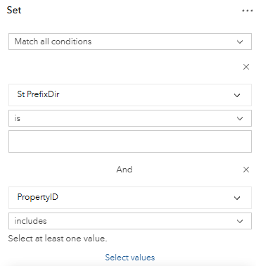

JoseSanchez
Thank you @JenniferAcunto
This is what I did and it worked.
