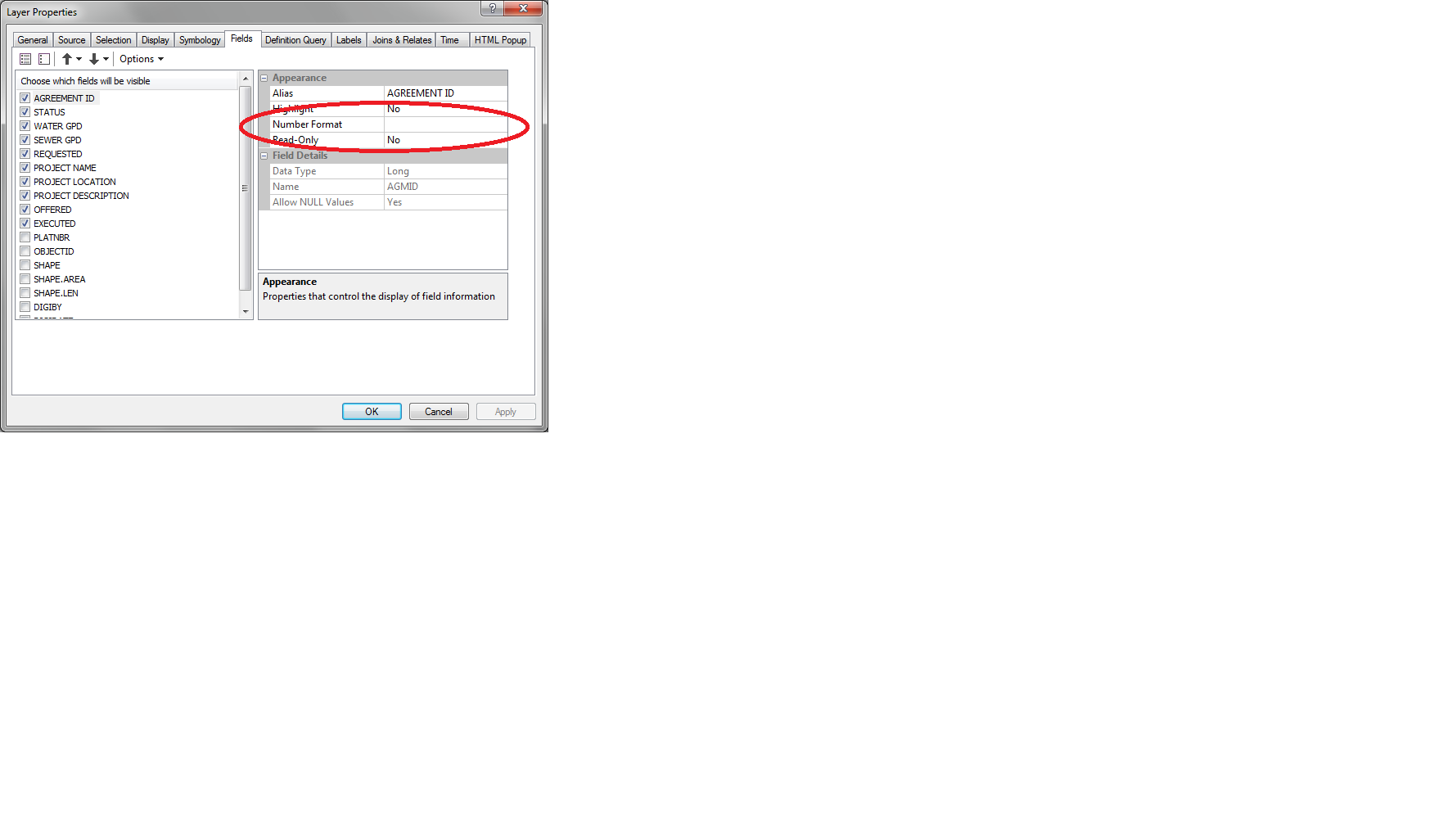

I changed the format of numeric field on arcmap document by ussing the layer properties and chaged the number format. In arcgis server service I see it currectly  but when you consumed the services on arcgis online map viewer the field is displayed in another format.  20,964 vr 20964

I do this all the time, but if I specify no thousands separator or decimals in the MXD, how come it does not respect it in the map service? When I am creating web maps w/popups, I am OK with re-setting the fields to display as desired. But I am thinking about a user who may want to grab a service and display quickly..... I would really rather them to see dates as 1993 and not 1,993. I suppose I can change the field types for this example. but it is not that easy when you inherit a lot of data to create new fields just so you can display them as desired.
Anything else I can do that is not a workaround? thx
