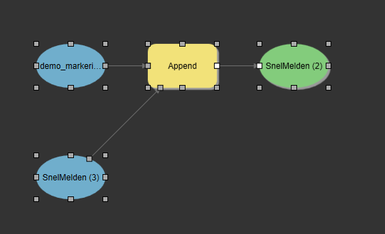

Solved it! Good old modelbuilder appending  a local feature class to the hosted one:modelbuilder.PNG
and the dashboard instantly responds ...
hth, Bert
