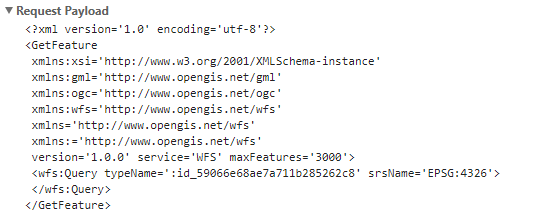

The ArcGIS Online makes POST requests with the GetFeatures parameters included in the body of the request (rather than a GET request with url parameters appended). It appears that the parameters are included correctly in the request but the WFS server is returning a 404 error. If the server is updated to accept POST requests, the layer should work.
This is what the request payload looks like:
