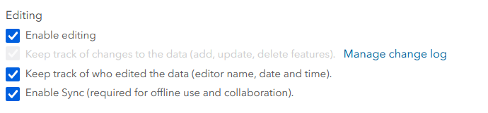

Hello,
I have a couple questions regarding the option in AGOL to keep track of changes to the data field (add, update, delete features).
  1. Is the purpose of this function to archive changes to any AGOL hosted feature layers?
  2. Can we view any changes (including deletions) in ArcGIS Pro?
  3. I noticed I cannot turn keep track of changes to the data on or off in the settings menu.  This is true even if I turn editing off.  Why is that and how can I turn keep track of changes off?
  4. Is there anything else I need to know about this function?
Thank You!

Koen
by Esri Contributor
Hey @LyonMNGIS
I was able to find documentation:
  • Also, if you publish a hosted tile layer from the hosted feature layer, and the hosted tile layer is configured to build tiles automatically, you cannot disable the Keep track of changes to the data (add, update, delete features) option on the hosted feature layer.
  • The Keep track of changes to the data (add, update, delete features) option allows custom applications to identify which features have been added, updated, or deleted. This setting is enabled automatically when you publish a tile layer from the hosted feature layer, because it is necessary to keep the two layers in sync.
Hope this helps! Feel free to reply to this thread with any additional questions.
- Koen
Koen
by Esri Contributor
Additional section in that article
  • Hosted feature layer views inherit this setting from the hosted feature layer from which they are created and cannot be configured independently. To enable or disable editor tracking for a hosted feature layer view, change the editor tracking setting on the hosted feature layer from which the view was created.

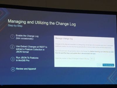

ChristopherCounsell
MVP Frequent Contributor
Hot off the ESRI UC I was wrong about change logs, apparently you can recover it as JSON. Explains why the logs get so large.
Have to use rest API.
mdibbinsSNO
Hi @ChristopherCounsell,
Would you happen to know if this deck was published anywhere?
JanetSilb_Spike
@ChristopherCounsell can you please explain how to do this in the new AGOL release: "more via REST API or ArcGIS Online"?  I've been trying to follow a process guided by ChatGPT but I think it may be outdated.
