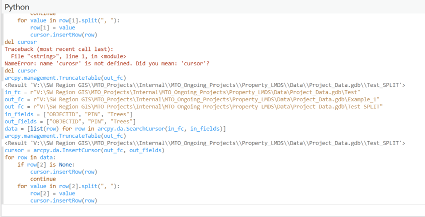

JohnEbbers
Hello Bob,
Thanks! This should work, but for some reason when I run the for loop nothing happens, I've included the relevant screenshots.
John Ebbers
BobBooth1
It looks like you are doing this in the Python Window in ArcGIS Pro. It might be better to do it in a Notebook in ArcGIS Pro, to save repeated copy/paste and to have a sense of what is working.
I would add some rows with print statements to get a view into the variables' contents at different places in the code. If the code is running without giving you an error message, the problem is probably a logic error in the code  - it is doing something, just not what you want...

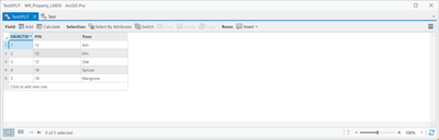

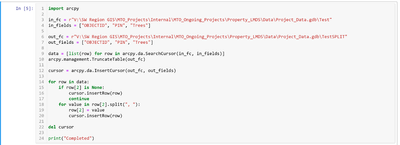

This is what finally did it, the error I kept on getting was actually that I hadn't signed in a so didn't have the proper license to edit the data. For future readers, this is the code that worked:
It is virtually the same as the one in the link sent by @BobBooth1 but I will mark this as the solution since the code is localized. Here are also screenshots of the tables that were used:
JohnEbbers_1-1762804586744.pngJohnEbbers_1-1762804586744.pngJohnEbbers_2-1762804594464.pngJohnEbbers_2-1762804594464.png
