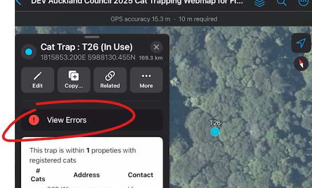

In short - When you use either Dot Notation (var attribute = row.fieldname) or Square bracket notation (var attribute = row["fieldname']) in an Arcade element in a popup in Map Viewer, it all works great until you open the popup in the Field Maps app.  Then you get the an error like this for that element in the popup....
What should i be using instead of dot notation or square bracket notation?  Do i have to make a dictionary first or something?  The code itself is being used in heaps of other places in the system so i know it all good, i just need to use an Arcade element for this particular element (instead of a Text element) for reasons too complex to go into right now (this version of the code works fine in the text element)
It seems like a crazy thing to get stumped on because dot notation is so common in all of our code.  For some reason i have never used it in an Arcade element in a Popup in Field Maps before.
For more context here is a small snippet of the code...

 Any ideas?  I am so close on this and this is the most straight forward thing about the entire thing!

FYI.  We figured it out.  If the featureset is derived from a non-spatial layer (ie a record table), dot notation and square brackets notation, inexplicably, do not work in an Arcade element.  We made a workaround by publishing the record table as a point feature layer with 150 records, all with no geometry, and it works fine.
Scott
