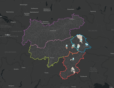

Hello ESRI Members,
I've set up a Dashboard + Web Map with two (WFL) layers:
  • Polygons
  • Points
I need the polygon layer to dynamically calculate and update the count of points within each polygon automatically whenever the point layer is updated.
The number of points will soon reach thousands, so I'm looking for a real-time processing solution - screen how it's looks today.
 What I’ve considered but won't work:
  • Arcade Expression  - only works for pop-ups, not attribute updates.
  • Summarize Within tool - creates a new layer instead of updating the existing one.
  • Feature layer (view) - The function adds attributes based on an attribute rather than a spatial function.
Does anyone know a way to achieve it ?
PS: I think about notebook will be a good for that - I don't know
Any insights would be greatly appreciated!
Thanks!
