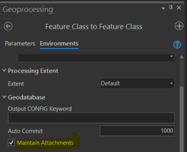

  1. In ArcGIS Pro, connect to your ArcGIS Online organization
  2. Execute the Feature Class to Feature Class tool, specifying the hosted feature service as the input.  You can browse to the hosted feature service.  By default, Maintain Attachments is enabled in the Environments:

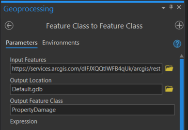

1.  You can execute the Feature Class to Feature Class by specifying the hosted feature service as your input:
2.  This will create a feature class and attachment table in your geodatabase:

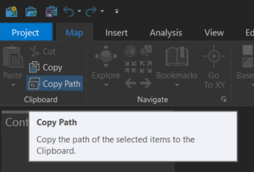

3.  Select the __ATTACH table in the Contents pane and under the Map tab in ArcGIS Pro, select the option Copy Path:

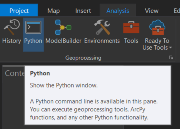

5.  In ArcGIS Pro, select the Analysis tab and click Python:

Somehow my additional steps were cutoff.  After you open the Python window in ArcGIS Pro, you can copy/paste the updated code with your directory paths into the section Enter python code here.  Click Enter a couple times and it should execute the code.
