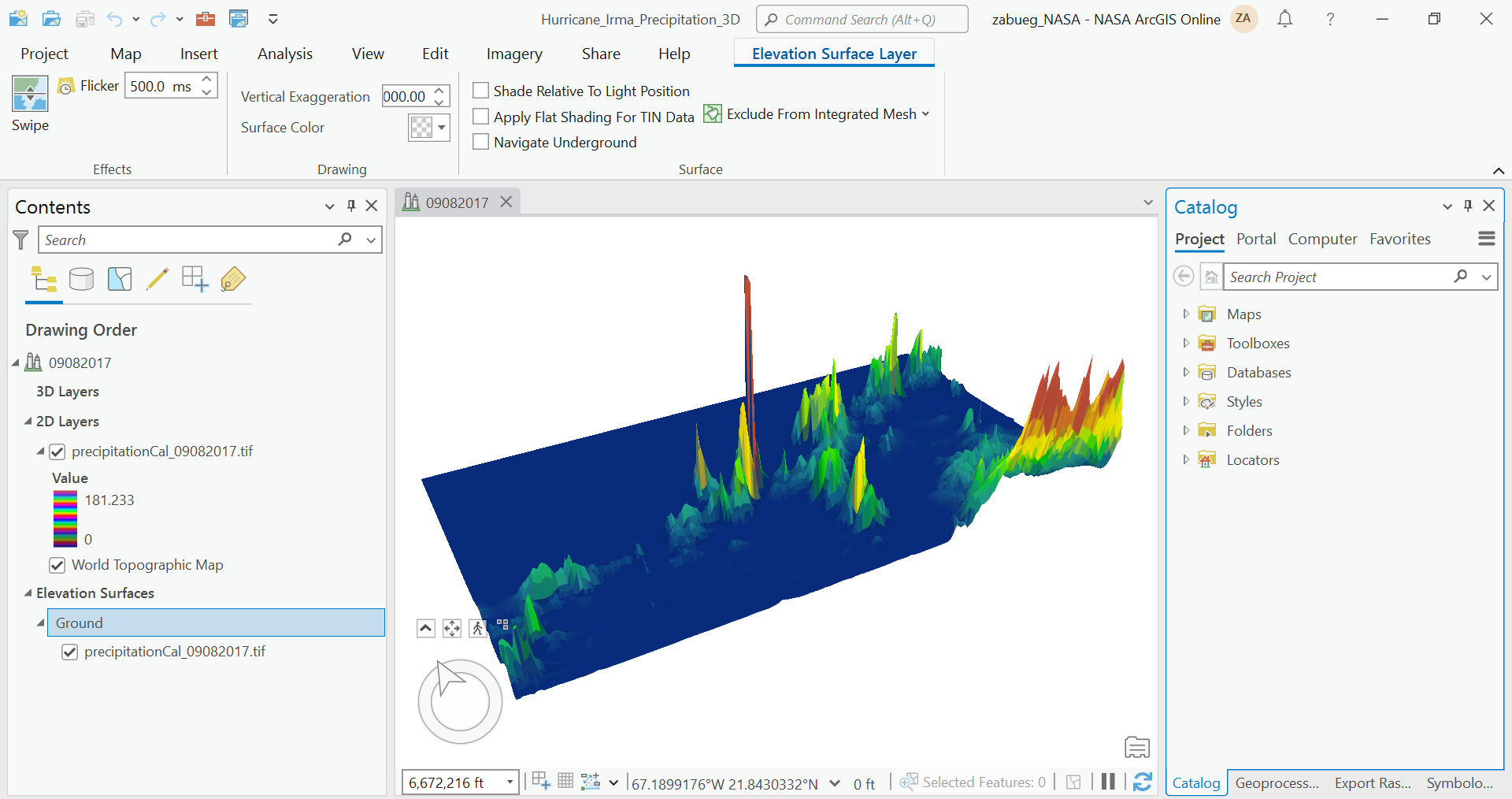

I have this local scene in ArcGIS Pro, where I've taken precipitation raster data, made it an elevation source, and vertically exaggerated the ground in order to show the data in 3D.
When I share this as a web scene to ArcGIS Online, the vertical exaggeration is not retained, which is a known limitation of ArcGIS Online (see here and here).
I've done research and seen people post about it here on Esri Community, but no one's posted an answer about how they successfully did it. My elevation unit was also already in feet (the smallest unit) so changing it to any of the other units wouldn't help.
Has anyone found a good workaround for retaining vertical exaggeration, or at least keeping its 3D effect, in ArcGIS Online?

Would it be possible to use Raster Calculator to apply the "vertical exaggeration" to the raster itself? You would create a new raster to use as elevation surface and keep the original layer for visualization purpose. The new raster would be your old values multiplied with the vertical exaggeration you want to apply.

This is exactly what did it! Thank you Andreas, this is perfect.
