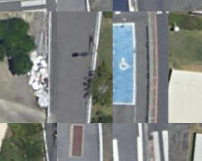

Hi Kelly,
Do you have any news regarding this bug ? It is still described as "new".
I uploaded 2 tile layer services to Agol, for the one in Web Mercator, resampling works well, but for the one in local projection (3163) it mixes tiles above the last level with tiles :

Hello,
after discussing with Esri support and testing various tile service publishing, I concluded that tile resampling only works on services with x2 tile scheme (ie. each scale must double in progression).
It is specified and mandatory for vector tiles layers : https://pro.arcgis.com/en/pro-app/latest/help/sharing/overview/configure-vector-tile-layer.htm
When vector tiles are generated, a contiguous mesh of square tiles is created for each level of detail (LOD) defined by the tiling scheme. The scale of the tiling scheme must double in progression. For example, if the scale is 1:2,000 at LOD1, it must be 1:1,000 at LOD2, 1:500 at LOD3, and so on.
But I haven't seen any recommendation for hosted tile layers.
So you have to either use Web Mercator coordinate system, that respects this tile scheme, or create your own custom tile scheme with your local coordinate system.
