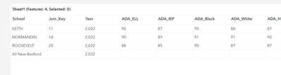

I'm having a reoccurring error that I'm hoping one of you very bright people could help me to resolve. I have a couple of excel spreadsheets that don't have location data that I've converted into hosted feature layers so that I can use them for dashboards. Everything normally works well, until down the road come the time when I want to update the data. When I try access the hosted feature layer to see and update the data, I get this error message that says "There was an error publishing the service." And I'm unable to access the data, even though the dashboard that was created with it is still working (for example, https://commonpurpose.maps.arcgis.com/apps/dashboards/4520200d62ef4316a74e41719bfa7222). This is a big problem for me because I need to be able to update the data annually. I've attached a spreadsheet of the current dataset thats giving me this error (an extremely simple dataset nonetheless, which makes this even more confusing), and a screenshot of the error message.

I hate to say it, but I don't get that error when I try publishing the same spreadsheet:
If something were causing issues, I'd guess it to be the empty cells in the bottom row. Null integers can throw errors in certain cases. Do you still see this error if you put 0s into the empty cells?

The only thing that stands out to me on your xlsx is in the "All New Bedford" row, the school and join key fields are merged. Maybe that is causing a problem? I would first try to unmerge those rows and if All New Bedford does not have a join key, to just leave that cell blank.

I thought that, too, but it's only how the sheet is rendering here on the Community. If you download the file, it's not merged.

@jcarlsonI'm unfortunately not able to put 0s in the All New Bedford row to see is that would help because it wont let me see the data at all. It just shows the error.

 @jcarlson if the issue is that I have empty cells rather than 0s this presents an interesting problem because for the datasets Im working with 0 typically means that the cell has a value and its 0, as opposed to instances when there are no values, for example, because the population is too small so a value cant be given because of privacy concerns. So if ArcGIS Online wants me to always have a value, and not be able to put in NULL or NA (because we know it doesnt like to mix up field types), then Im not sure how Id be able to make that necessary distinction. Thoughts?

Even though you won't be working with fractional values, setting the field type to a decimal / double would allow nulls. Also, it's not surprising that the update process is giving you problems. I've also had issues with null integers during updates, and I believe it's got something to do with one of the backend processes that you unfortunately don't have any access to change.
