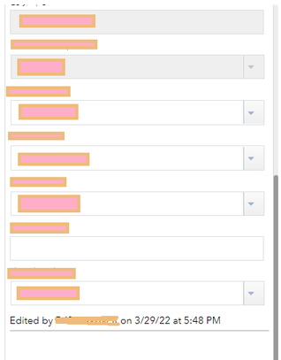

Hi all,
I have an issue with web app builder application, exactly in smart editor.
I wonder if is it possible to hide the text below "Edited by username on 3/29/22 at 5:48 PM"  ? Like the example in the image
thanks in advance.

There might be a way, but the only way I have found to get rid of that is to disable editor tracking.
R_
AlixVezina
Hi @Hala_Ghareeb ,
Right now you cannot hide it from the Smart Editor any other way then by disabling editor tracking from the layer settings.
