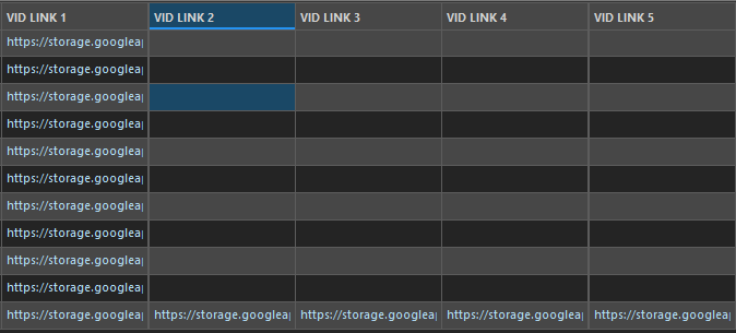

I have data with video link attachments. Some have up to five links associated with them.
I'm trying to configure the pop-ups so that, if there is only one video, only one video player will show up.

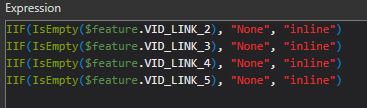

I've added the following expression via arcade:
and this is my HTML code. I'm looking at lines 20 and below for the video formatting

This code still shows all five video players even if the attribute is blank. I want it to only show one if there is only one video.
I've tried a few different iterations of the code but nothing seems to work. I've tried it in AGOL and ArcPro.
Any help is appreciated! Thanks!
