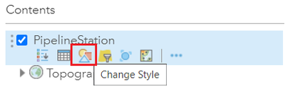

I have what should be a pretty simple question that I can't seem to figure out.
I have a feature service in a map on ArcGIS Online which I use to store points collected in the field. I used it 3 days ago and all the points collected were showing on my map. But now the points/styles are not showing or are hidden. What setting in ArcGIS Online controls how styles are displayed? I should know this but can't seem to find the setting.
I included an attachment showing what I mean.

You could control the style using the change style icon.
Also check
1. If the values are available in the field used for symbology.
2. If the layer is published/republished from ArcGIS Pro/ArcMap, please ensure no transparency was used before publishing.

Thanks for the reply Jayanta!
I figured out what was wrong right after I made my post. I had changed the values for my point feature to a value that wasn't in my list of domains I had set up for the map.
