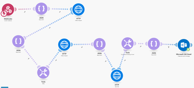

I have had similar issues although I found the documentation useful. I have created a similar workflow in the past please see the below image, you will not be able to view the attributes directly, however, there are some steps involved. You can refer to the below image:
Hope this helps.
Cheers,
Manish

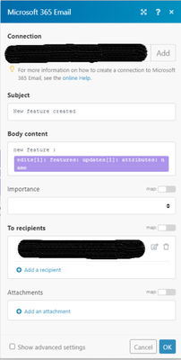

When you say "You will not be able to view the attributes directly", do you mean they won't come through on the email? I managed to get an email to send using the JSON mapped values from the change table, but the email just comes through as blank.
