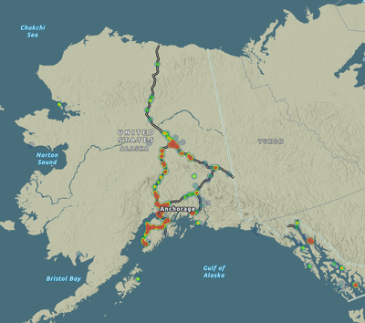

I am making a webmap that shows my point data as a heat map. On a broad scale, I want to display my heat map the way it is currently showing. See photo below.

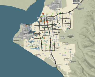

Unfortunately, I run into trouble when I zoom into a specific community, for example Anchorage shown below. I do not like the way the heat map is rendering at this scale, as it takes away from my main message that I want to convey to my audience.

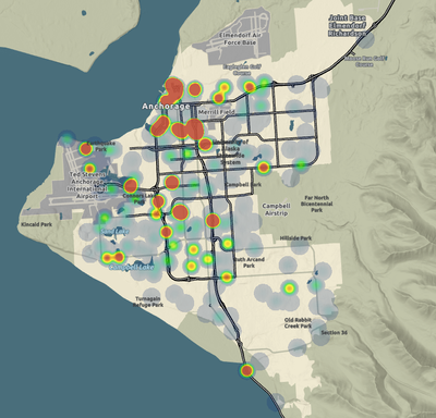

Therefore, I locked my radius at the fine scale and I do like the way it is now showing Anchorage. See photo below:

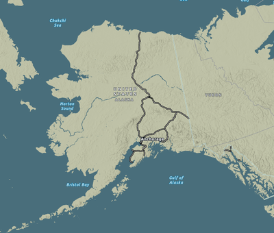

Unfortunately, the trouble that I now run into is the broad scale, it no longer looks like the way it did before I locked my radius. See photo below:

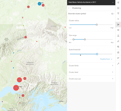

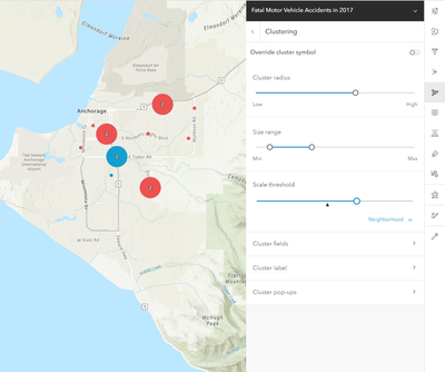

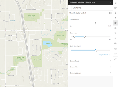

The threshold set at one level might not be the threshold you want at this range of map scale and data distribution. I think using clustering under the aggregation panel in Map Viewer might offer you a view of your data showing your features aggregated. You can also set a scale threshold which once you pass it you will see the individual features.
Sample Map https://jsapi.maps.arcgis.com/apps/mapviewer/index.html?webmap=61ee01f6b02447049f6ce8ff077e356a
Showing clusters at street view
Passing Scale threshold
