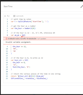

leahmaps
Fingers crossed this will work - just getting the weird issue with arcade having invalid variables.

That's really odd. I use Arcade this way all the time without issues. Does it let to attempt to run the code, or does it insist there's a problem?
Try adding Console(the_hour) above line 8, see if it sends anything to the console.

Oh sheesh. I forgot the closing quotation on line 11. Should be 'AM'.
