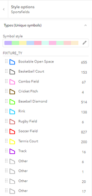

Is it possible to group features in a legend in ArcGIS Online Map Viewer?  Not to group layers but to group features from the same layer in a legend together.

I don't have the most recent version of Online so do not see this option.  And I'm in New Map Viewer.
I'd like to group all "Other" together - there are even more than are shown in this screen shot.
temprobertcottreau131313_0-1708007890456.pngtemprobertcottreau131313_0-1708007890456.png

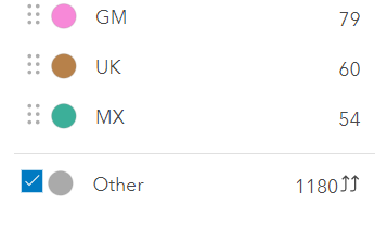

At the bottom of the list do you see  a line for other values. You can drag those others into that section by clicking on the 6 dot button and dragging it into the other section.
Thanks, that works part way.  The only problem is that now when I click that feature in the map the popup box shows it as "Other" rather than what it actually is.  Maybe there's no way around that.
