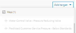

Is this resolution only available for ArcGIS Online? I'm still having the same issue, but I'm using Enterprise version 10.9.1. See screenshot below. The grouped layer is still not being recognized as target for filters on the map.
