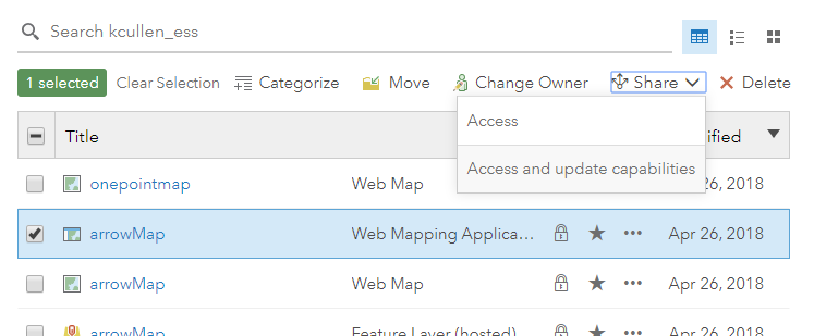

When you created the group which option did you choose for "what items in the group can its members update?"
If you choose "All Items" this group is considered to have "update capabilities"
 and will not appear in the share dialog. To share to this group go to the content page > choose an item > click share > choose "access and update capabilities" and you will see the group.

After multiple tries asking this question through geonet I finally had found someone who noted that I needed do this through 'my content'. I was completely unclear to me from the other entries how to make the choices for Access appear, and even from that it was really just by poking around that I realized that if I checked the box by the file the 'share' option with access etc appeared!
Anyway, this is helpful and the problem resolved. Thanks so much for getting back to me.
