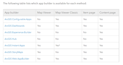

Judging by this table, perhaps not. Instant Apps looks to be the new web app builder for Map Viewer.
https://doc.arcgis.com/en/arcgis-online/create-maps/create-map-apps.htm
Edit: Experience builder is the new WAB. 👍
