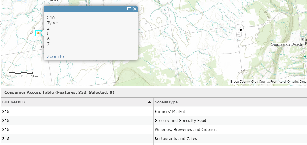

I have a related table that is published to my portal with a many to one relationship with my feature class.
I'm trying to pull the related records from the table into the feature class' popup using the following script(adapted from here):
var tbl = FeatureSetByName($datastore,"ConsumerAccess")
var ftr = $feature["Business.BusinessID"]
var sql = "BusinessID = '" + ftr + "'";
var txt = Filter(tbl,sql)
var outtxt = ""
for (var accesstype in txt){
    var txts = ConsumerAccess.AccessType
    outtxt += txts+TextFormatting.NewLine
return outtxt‍‍‍‍‍‍‍‍‍‍‍‍‍‍‍‍‍‍‍‍‍‍‍‍‍‍‍‍‍‍‍‍‍
I have tried using the DomainCode and DomainName functions within the declaring of the variable txts but I cant seem to get the description from the value. For example:
Thank you in advance if you have any suggestions

That worked!, I just needed to change one bit,
var outtxt = ""
 var txts = DomainName(accesstype, "AccessType")
I don't know why I was having so much trouble with it.

Hi Joel,
Try this:
var outtxt = ""
    var txts = DomainName($feature.accesstype, "AccessType")
return outtxt
Can you share your web map so I can test this out?
Let me know if it gets you up and running and see you at UC.
