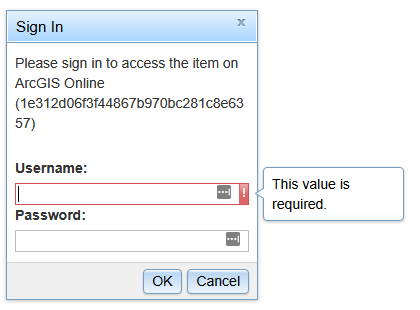

So I'm trying to prop up a GeoForm.
I need it to be on our Internal server and available to Employees not citizens.
SO!
I have the following:
A feature layer of points. A webmap containing those points. An Application referencing the GeoForm hosted on our server (internal address so I can't share).
What I get is this...
I'm about to pull my hair out.
In default.js I have entered the APPID, WEBMAP, FORM_LAYER and FIELDS as well as our internal Proxy and SHARINGHOST.
Now if I sign in with my ESRI account then it works. I haven't submitted a new address to test, but it loads and shows the fields I setup and everything. It LOOKS like I expect it to look. BUT... I don't want users to have to sign in. The very nature of where I put the GeoForm (internal server) means only internal users can access it. But if I SHARE the AGOL objects with the public then theoretically I could end up with outside users creating points. I do not want that.
I'm thinking that maybe I configured the proxy incorrectly?
